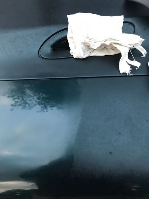

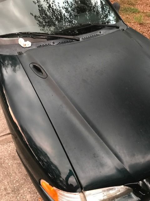

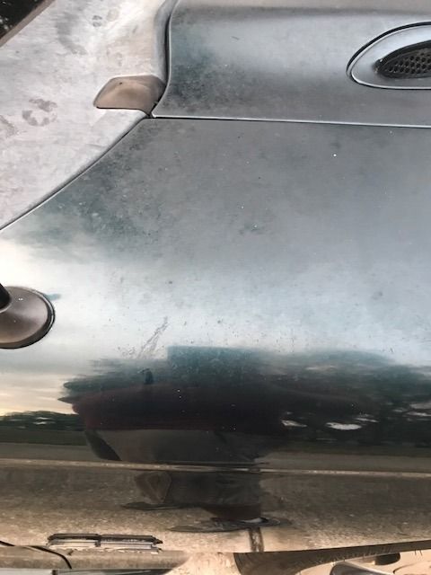

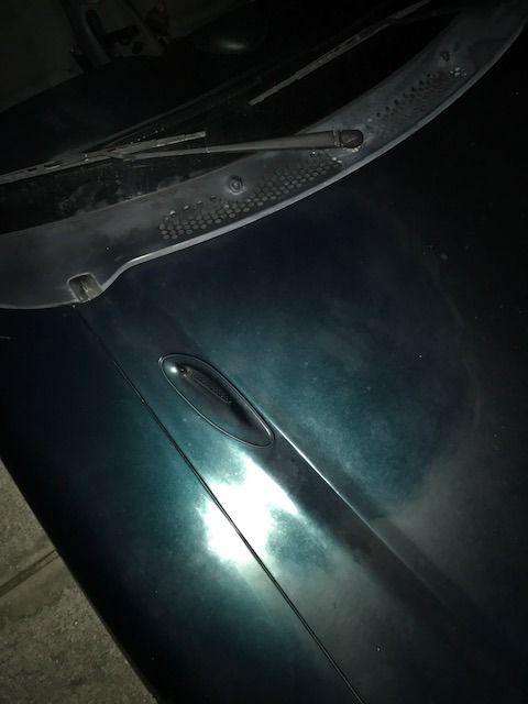

1 hour ago, Blackmage said:
looks like the clear coat might be gone as well. are you pulling up any color on your rags when your using a cleaner wax?
No paint was coming up when I was doing it
Link to comment
Share on other sites
if you know how to run a high speed buffer, this is what i would recommend.  only if you're not getting any color on your rags when using cleaner wax.  if you are getting any sort of color other than the white wax, you're pulling paint and this process will not do anything.  read through the information links on each product, they'll describe what pads to use and what speeds.
http://wizardsproducts.com/mystic-cut-8-oz/
then use this
http://wizardsproducts.com/mystic-nano-wax-8-oz/
