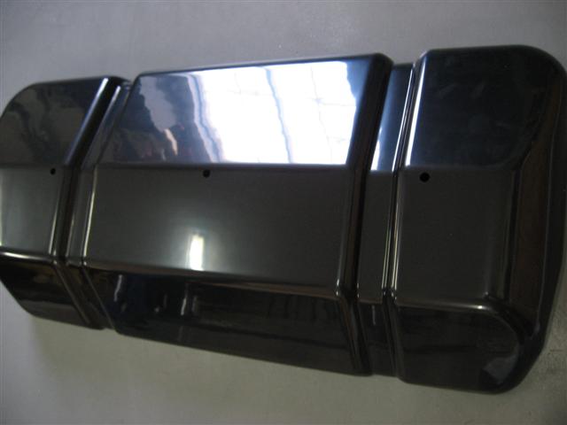

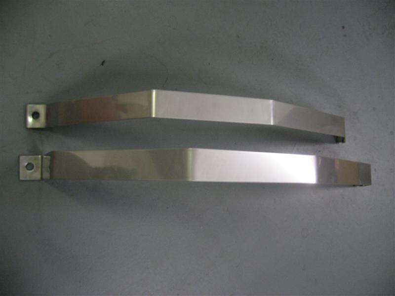

fry Posted July 29, 2012 Report Share Posted July 29, 2012 The rear end of my car is the only part of it that makes me smile at this point. However, the gas tank cover is a huge eye sore! I wanna paint it, but I'm confused about a couple things. 1. what kind of paint do I use? Can I use the same paint for the straps and the cover, or do I have to use plastic paint and metal paint? I have leftover caliper paint, would that work? 2. Do I have to sand it down, like scuff it up? Can I just put it in the media blaster and use that instead? 3. Anything else I need to know about painting it?haha seems kind of like a small detail but I want every last detail on my car to be perfect! Link to comment Share on other sites More sharing options...

mavisky Posted July 30, 2012 Report Share Posted July 30, 2012 Is yours that bad? I just cleaned mine up with some mothers back to black and then later taped off the straps, scuffed them up with some scotchbrite, primed and painted them gloss silver. Looks great now. Link to comment Share on other sites More sharing options...
Number Tew Posted July 30, 2012 Report Share Posted July 30, 2012 You could probably plasti dip it, just clean it up and shoot that on there. If I was repainting it, instead of just cleaning it (I would clean it with purple power and armor all, it's how I do mine) I would sand it down with maybe 400, wipe it down with mineral spirits, let it dry, then shoot some semi-gloss black on it. The straps I'd do the same way if they actually need it. However, if I was being really adventurous I might bedline the straps for a rugged contrast, or I'd polish them, because I like doin that schtuff haha Link to comment Share on other sites More sharing options...

Number Tew Posted July 30, 2012 Report Share Posted July 30, 2012 You may want to go down to 220 now that I think about it. Do what the paint can reccomends, every brand is a bit different. It's super smooth so it will need sanding before actual paint, needs something to bite in to.It might have little barbs where rocks knock it rolling down the road, knock those down with the sand paper too Link to comment Share on other sites More sharing options...

JoshHooten Posted July 30, 2012 Report Share Posted July 30, 2012 I think I just used regular krylon and I used some caliper paint for the straps. I used the same semi gloss on the lower part of the rear bumper. Link to comment Share on other sites More sharing options...

330CubeGt Posted July 31, 2012 Report Share Posted July 31, 2012 Painted mine with gloss black rustoleum while on the car with hardly any prep and it looks good and is still holding up after 8+ months... Heads up and ass kickin! Using Tapatalk 2 Link to comment Share on other sites More sharing options...

fry Posted July 31, 2012 Author Report Share Posted July 31, 2012 Painted mine today! Looks fuckin kickass! Link to comment Share on other sites More sharing options...

JoshHooten Posted August 9, 2012 Report Share Posted August 9, 2012 My plastic cover was in bad shape,so I just cleaned it up and spray painted it. I didn't even remove it, but it turned out pretty good.BeforeAfter Link to comment Share on other sites More sharing options...

smallblocksn95 Posted August 10, 2012 Report Share Posted August 10, 2012 I sprayed mine with krylon fusion for plastic, a year ago.... Still looks good Link to comment Share on other sites More sharing options...
